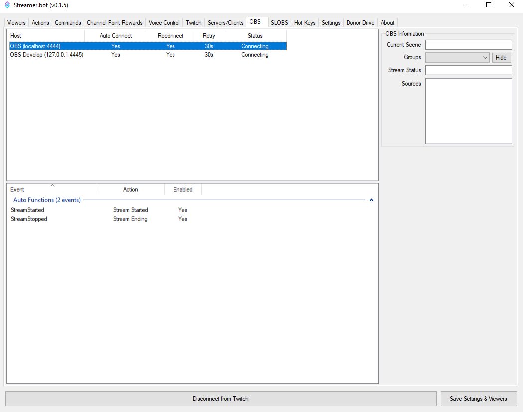

Create an OBS Event for StreamStarted and tie it to the Stream Started Action and make sure it is Enabled.
Create an OBS Event for StreamStopped and tie it to the Stream Ending Action and make sure it is Enabled.
